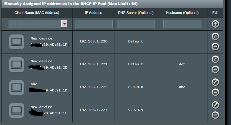

Thanks for this great addon. Installed it on my RT-AX88U because of 80+ DHCP recervations.
The only thing not working yet in the GUI is the 64 devices limit. Changed 2 times addRow_Group(25) to addRow_Group(254) in the Advanced_DHCP_Content.asp file and it works!
Thanks again for this nice and very helpful script.
Addrowgroup is currently at 128 to see if that's enough. It can always be increased if the character count of the reservations isn't met by someone using all 128 rows.
