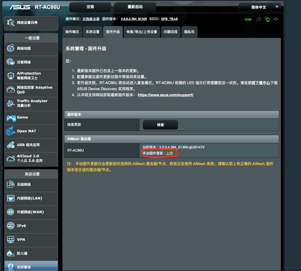

Good evening,
I have a big problem, I updated my RT-86U with the latest version of the official Asus firmware, and I end up with everything in Chinese ...
If I click on the language button at the top right, I can see English, but when I click on it nothing helps.
So I downloaded the latest version of the Merlin firmware, but when I try to install it manually, I indicate the firmware, but there is no tool to validate.
How to do it please?
Thank you

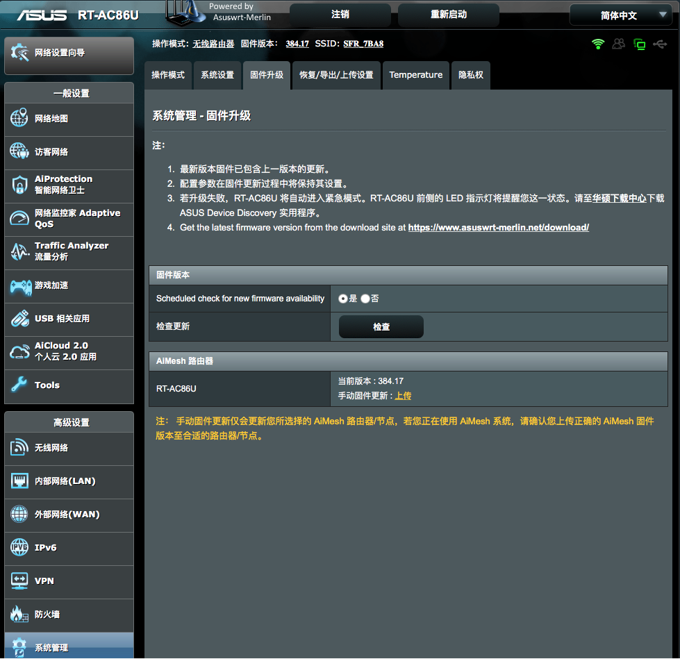

Finaly I installed the Merlin firmware up to date thanks to the recovery, everything went well; unfortunately, but after restarting the router, it remains blocked in Chinese ...

This is by design. To prevent grey market abuses, Asus hardcodes the language in a few regions. So if you have Chinese model, it will be hardcoded to Chinese.

Only if your router is in a non-locked region. China and Japan are currently locked, and limit which languages are available.
