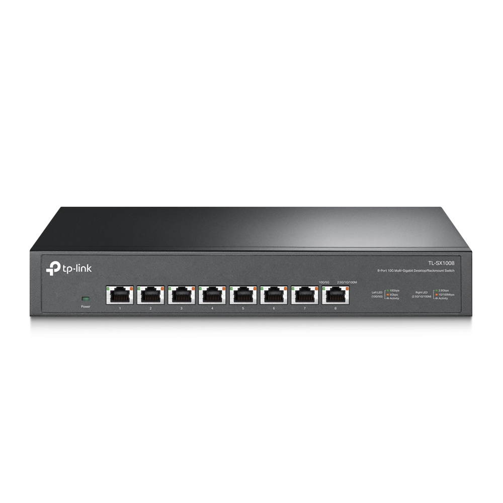

10GBASE-T uses RJ45; 100m on good CAT 6A installation and 55m on CAT6. TP-Link has a new 8 port 10GbE unmanaged switch: TL-SX1008
