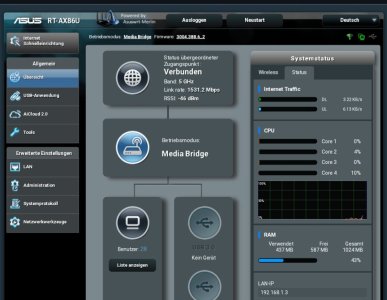

I replaced an old AC68U media bridge with a fresh AX86U on latest merlin firmware (factory resettet) and there is no port status displayed (it was on the AC68U). Could this be a bug, or am I missing something?

Thank you, all Asus AX here but I don't want to use AiMesh for reasons. As in router mode the port status is there I'd assume something is wrong with media bridge mode landing page. But I can't debug it so I was thinking if someone can confirm that. It's not a big thing at all but maybe could be fixed easily? :)
I played a little bit with chrome tools and found that "/ajax_ethernet_ports.asp" reads the ports on the status page. When I call it manually on the media bridge I get:
get_wan_lan_status = { "portSpeed": { "WAN 0": "X", "LAN 1": "X", "LAN 2": "M", "LAN 3": "M", "LAN 4": "M", "LAN 5": "Q" }, "portCount": { "wanCount": 1, "lanCount": 5 } };

So the status can be read but the part which displays it is missing. But no idea why...
Edit:
This is also called regularly besides cpu stats and others:
http://192.168.1.3/get_port_status.cgi?node_mac=7C:xx:xx:xx:xx:xx
Same on the one working in router mode.
In your chrome tools change the applicable CSS "display:" value (am thinking it's "none" for some reason) and see if that doesn't show it.
Thank you, will try to find it in Chromes developer tools. But obviously it sounds like a bug, right? No filter tools or anything installed in Chrome, same behavior in Firefox also.
Update: Reflashed it today to latest Asus firmware followed by a factory reset. Configured it as media bridge and port status is still missing. Used the feedback form inside AsusWRT to report it to Asus...
