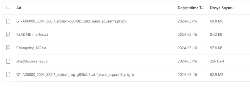

There are two installation files, which one should we install?
Republic of Gaming (ROG) routers, like the one shown in your screen capture (GT-AX6000), will typically have two Asus-Merlin firmware files.
The basic GUI firmware file: GT-AX6000_3004_388.7_alpha1-g83fdb5cabf_nand_squashfs.pkgtb
And a Republic of Gamers (ROG) GUI firmware file: GT-AX6000_3004_388.7_alpha1_rog-g83fdb5cabf_nand_squashfs.pkgtb
The ROG version typically has the Republic of Gamers GUI (different layout and colors) and may have a few features or settings specific to Republic of Gamers use.
Which one to you use is up to you.
