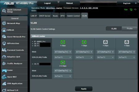

I would like to know if you can include a LAN port in an SDN or VLAN group
On stock firmware, yes you can include a LAN port with a Guest Network Pro (SDN) group. I assume it would be the same under this alpha firmware for the RT-AX86U Pro. Have not tried this alpha yet on my RT-AX86U Pro.
See the LAN > VLAN page.
Under LAN --> VLAN --> Select the port --> Select to trunk or access --> Select the VLAN of choice:

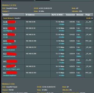

Now that we have the Guest Network Pro. is it possible to have a "extra" Wireless Log TAB for these GN networks?
Guest Networks are integrated into the same Wireless Log. Here's an example from my RT-BE96U main router - that network is on a separate VLAN, and is also connected to a Wireguard VPN client:
As indicated in multiple posts already, the Wireless Log in these alphas is not working at this time. Asus redesigned the way wireless networks are handled in 37xxx, and these alphas are currently a mixture of my 37xxx code and Asus' 36xxx GPL. I still need to revert my 37xxx specific changes for this to work.
These builds are still very early work in progress builds.
Yup.
Here's mine. FYI. IoT network.. RT-AX88U Pro, hard reset install. Some more observations re Asus's still flaky Network Table in a separate post.
