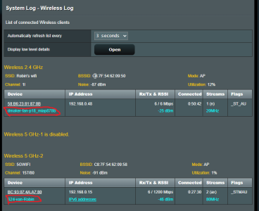

Wireless Log is now working on my GT-AX11000 Pro with the latest Alpha 2 build but it's only is displaying MAC addresses, no hostnames
yes same here
yes same here
No, you have host names just fine...
Or you mean your designated ones under LAN - DHCP Server (or under Network Map - Client List)? Works for me.

And you have host name (client name) just fine on both... Static IP has nothing to do with it.
So where is the issue? Can you edit (change) the names by clicking on them, and that it sticks everywhere?

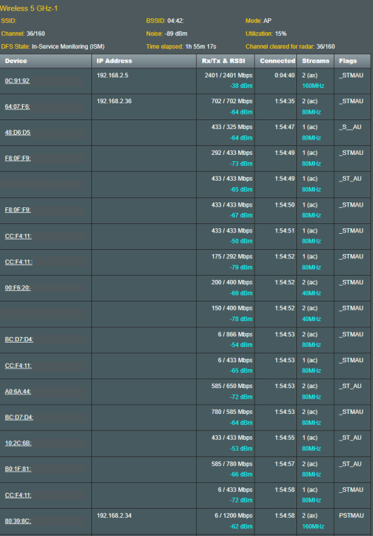

My GT-AX11000 Pro does not show hostnames at all and a lot are missing IP addresses on the 5Ghz radio for some reason.

edit the hostname of my phone
it does show at network map
but not at wireless log the updated version/name
Tried to reconnect device?

I have DHCP reservation on the LAN page with name changed there, so don't know...
Because it says client name on Client List page, and host name on LAN page; so probably not the same...

Your router is in AP mode?
Yes
