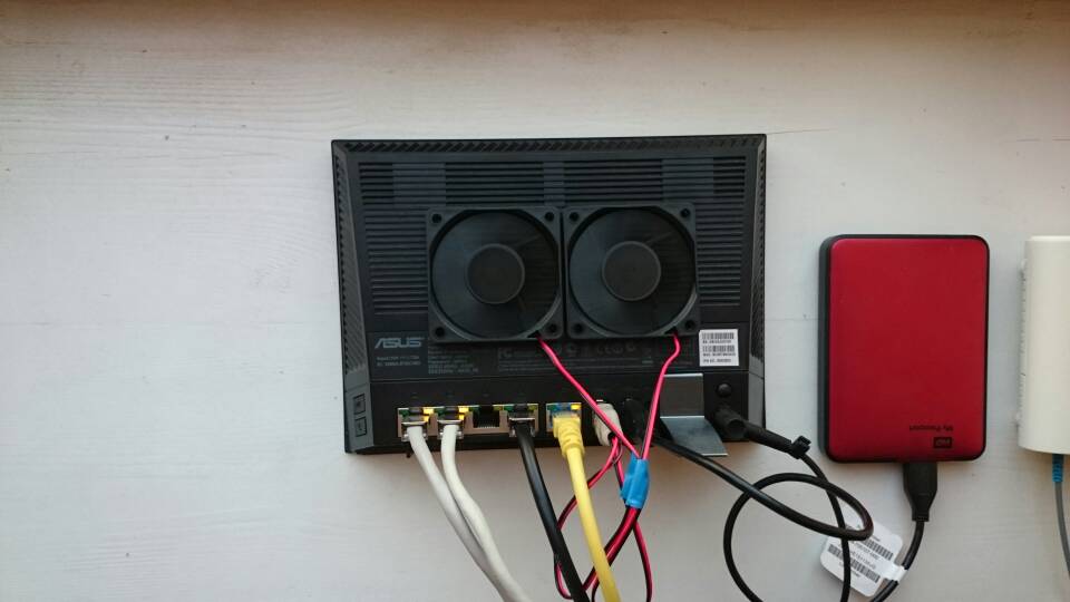

This summer I noticed that my rt-ac56u Temps reached over 80°C even though this should cause no problem I've decided to install cooling solution ;) the Temps went from ~84°C to 59-61°C
Both ventilators pushing air in

I followed your idea on my RT-AC68U and got 2 x 12V fans running on 5V USB power, to replace my 2 small USB fans (#44 above). They do indeed run albeit a lot slower than at 12 V. Nevertheless, they reduced the cpu temp a further 3degC to 62C and are silent. But the useful thing to note is that moving a bigger volume of air at low speed can be more effective than moving a small volume of air at higher speed.
(Fans held in place and sealed around the edges with hot melt glue - fairly easily removed if needed. And deliberately offset to allow acces to reset button.)
As already stated, my router ran without a hiccup for 18 months at 80C, so I'm not proposing this as a necessary mod. Just for those who like to tinker.
