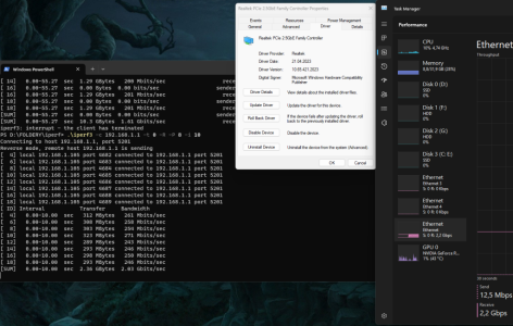

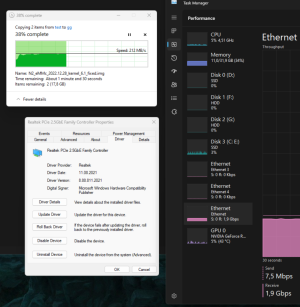

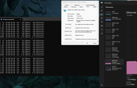

In your "working" screenshot you were getting 1.59Gb/s from the router and only 884Mb/s from the New NAS. Try removing the USB adapter from the New NAS and use the original 1GbE port. Then test again and see if you get consistent results. Even though the New NAS would only have 1GbE you should still be able to hit 2.5Gb/s in combination with the router on your PC.And here's a screenshot when the Switch bug is not present:
So easily getting 2.5Gb/s then.
No, my Internet upload speed is only 100Mb/s, so that would be way slower. It just goes to the Asus router and then back to the PC as a local connection transfer. That NAS is unreachable from Internet anyway.Are you sure the NAS isn't trying to send data to the internet when you have this problem thereby reducing the bandwidth to your PC?
Sorry, that screenshot was misleading and had result of a different test performed before. I'm getting over 2 Gb/s from the New NAS (as in the screenshot from the post above): https://www.snbforums.com/attachments/iperf3-png.51771/In your "working" screenshot you were getting 1.59Gb/s from the router and only 884Mb/s from the New NAS. Try removing the USB adapter from the New NAS and use the original 1GbE port. Then test again and see if you get consistent results. Even though the New NAS would only have 1GbE you should still be able to hit 2.5Gb/s in combination with the router on your PC.

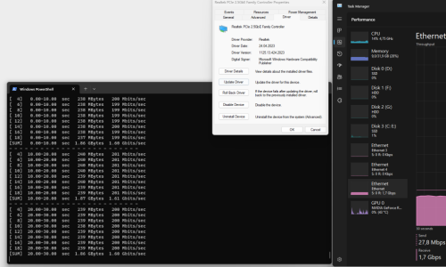

Were those two tests done when "the problem" was happening or in "normal" conditions? Apart from the unbalanced load the throughput to the PC is the same, ~1.7-1.8 Gb/s.
