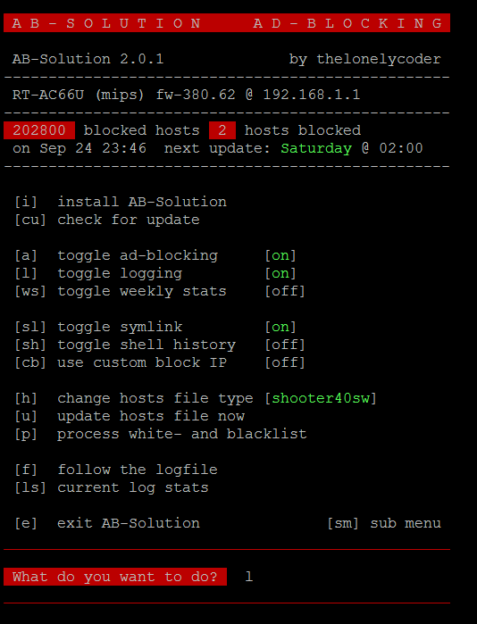

Is this one working correctly?
Absolutely!
From the App's viewpoint, there are no configuration errors, no missing files, no missing entries in the /jffs/scripts/ files.
Otherwise it would tell you when you start it.
This is a fresh installation. While installing it, it already blocked 2 ads and counted it.
Next automatic counter update is Saturday at 2 am. The (u) option updates that counter as well.
