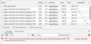

@HELLO_wORLD,
The Aegis web cgi returns a HTTP status code 500 on clicking the Log tab the first time, although that does not prevent the page from displaying the log entries, so I don't know if you would want to look into this or not. Just for your awareness. Screen snippet attached. Thanks.

@HELLO_wORLD,
Thanks. This is normal ;)
uhttpd limitation (returning 500 when data is too long to its taste, but still sends the data, so it is ignored).
