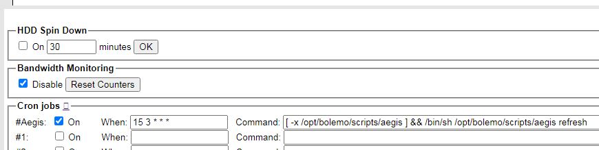

n1llam1
@HELLO_wORLD,
Circling back to the issue that I previously ran into with the CPU usage on my R7800 device in router mode becoming pegged near 100% most of the time, I have again noticed that the System Load Average numbers started creeping up after about 12 days of continuous up time.
Again, using top2, I saw that iptables remained in the process list. This time I was able to track it down to the repeated use of the "iptables -nL RRDIPT" command by the @kamoj add-on, particularly for bandwidth monitoring. Since I do not have a need for bandwidth monitoring, I have disabled that feature and observed that the System Load Average numbers dropped and remained relatively lower.
For example, currently I see (System Load Average last: 1/5/15 minutes: 0.37 / 0.83 / 0.86). Prior to disabling the bandwidth monitoring, the load average numbers were all above 2.00.
I have around 50 devices (wired and wireless) connected to the router so bandwidth monitoring would need more CPU time to process the list of connected devices. In my case, disabling bandwidth monitoring helps to keep the CPU usage as low as possible.
n1llam1
What is the disabled option (for bandwidth monitoring) that you refer to?
Is it this one "Disable: Traffic Meter service"
It is at the top of the Kamoj Menu->Settings page, as seen in the screen snippet below.
HELLO_wORLD
Very Senior Member
Thank you for the follow up :)
So the issue seems to be unrelated to Aegis.
Since it is linked to the bandwidth monitoring feature of the @kamoj addon, have you reported this on the thread for the addon?

kamoj
Very Senior Member
@HELLO_wORLD,
Could it be that the Aegis "nightly update" is run by a cron job at the same time as the Bandwidth monitoring?
Both "programs" use the net-wall to update the iptables.
You can on the net-wall log by:
touch /var/log/net-wall.log
If you use the add-on default, try to change the Aegis cron job to not run simultaneously with Bandwidth Monitor:
[ -x /opt/bolemo/scripts/aegis ] && sleep 29 && /bin/sh /opt/bolemo/scripts/aegis refresh -html
