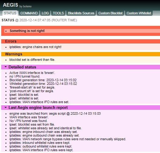

and already a couple of mornings that I open the router and see like this
Same here - and the launch was around the same time 03:15 this morning
Restart seems to clear it
After a Clean and Update it is OK
Ok, the error you are encountering is minor (rule in double, not preventing aegis to work).
It seems that it is when it is called from the crontab.
Can you share the command used in your cron at 3:15?
If you are using @kamoj add on, it should show somewhere in his add on settings.

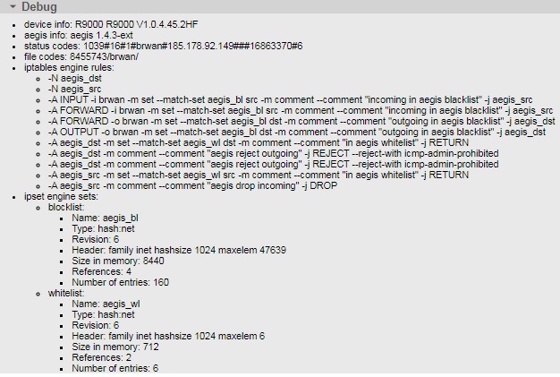

I am using Kamoj addon V5.4b13 (R9000 Voxel V1.0.4.46).
/tmp/addons/cron/cronaegis/crontabs:
15 3 * * * [ -x /opt/bolemo/scripts/aegis ] && /bin/sh /opt/bolemo/scripts/aegis update
Thanks.
If you manually just run aegis update, do you have the same problem?
