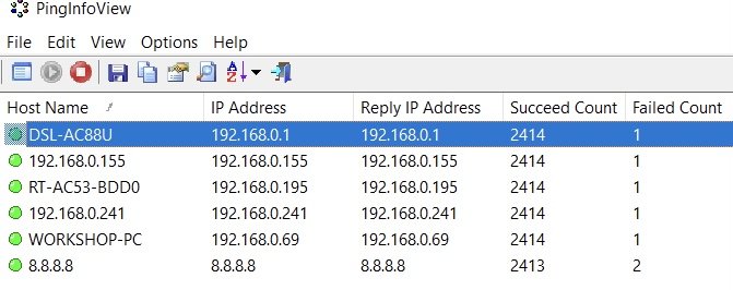

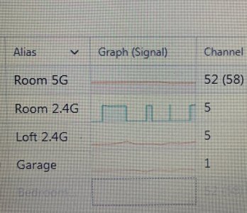

I’m not using guest WiFi. To eliminate the switch, I’ve temporarily bypassed it. I’ve been running a ping test, pinging my wired desktop, all the nodes, an AP and google every 5 seconds, this is after 5 hours from a laptop connected to a node and it doesn’t appear to be as bad as I thought 🤔
Start over and get one wireless router working. Then build out one step at a time. Watch out for an AC86U acting weird... it has a history of losing power regulation and the 2.4 radio or radios in general.
