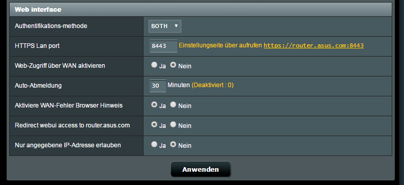

For this to work, you have to enable Persistent Certificate support on the Administration -> System page.
I do not have such a setting option (380.67 alpha 2, Cache emptied):
Are you sure you really have 380.67 alpha 2 running?
Yes
For all browsers the same (cache emptied) ...
Chrome 58.0.3029.110 (64-bit); Firefox 53.0.3 (64-Bit); IE11 11.0.9600.18665
