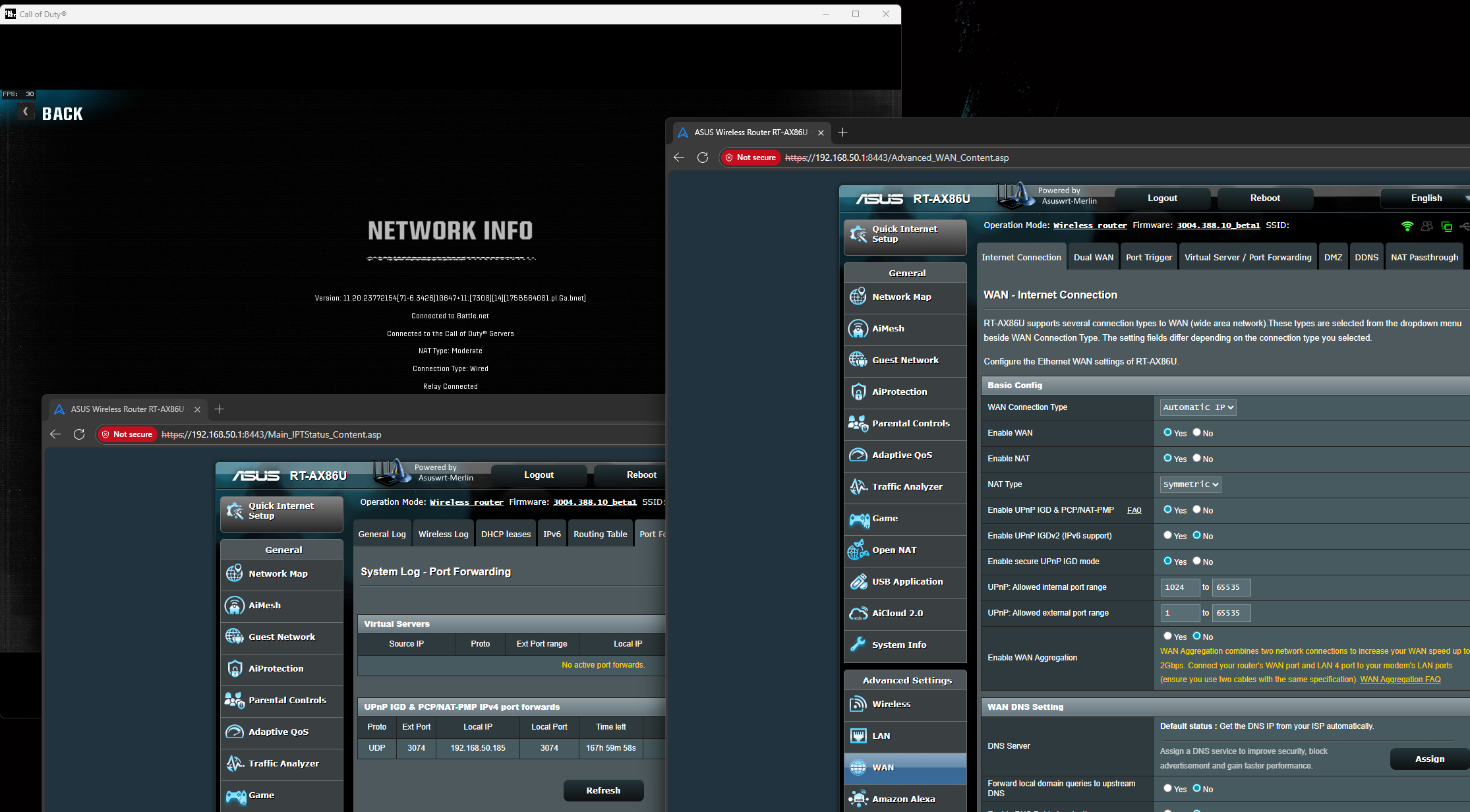

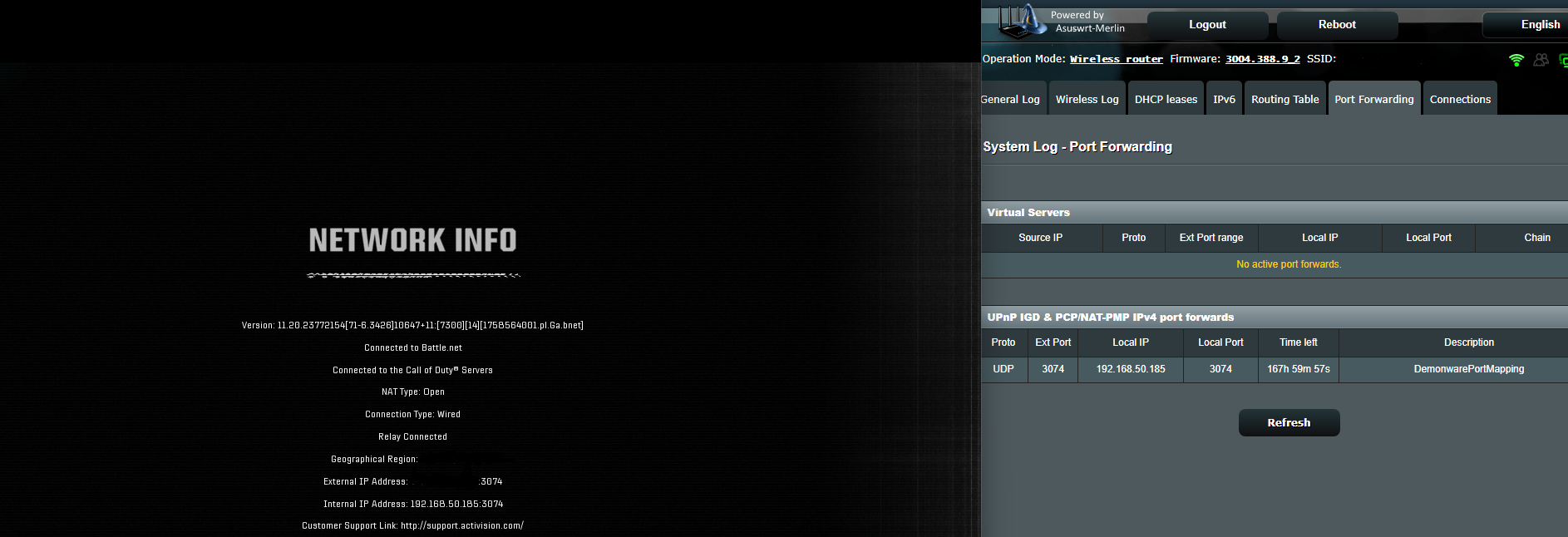

Edit: with some testing, 388.9 works flawlessly with upnp. Anything after this including stock with upnp disabled windows doesnt like. Can anybody else do some testing? Specifically with call of duty on pc as any firmware that has upnp disabled by default doesnt seem to work correctly. Upgrade without wipe works from 388.9 to 388.10 with nat being open.
Doing a restore via router on latest firmwares sets upnp to disabled by default and when enabling this is where the issues start. Enabling Upnp seems good, the log shows the port being forwarded but windows is not getting the port opened.
Could simply be Windows not realizing that UPnP has been re-enabled. Try rebooting your computer after enabling UPnP on the router.
Bottom line, there hasn't been any change to UPnP in many months. The only change in 388.10 is that if you do a factory default reset, then it will be disabled by default.
Already tried multiple resets and even another Windows install on another disk. Hopefully somebody else on windows with a fresh install of this beta on ax86u or similar can test using a game.
