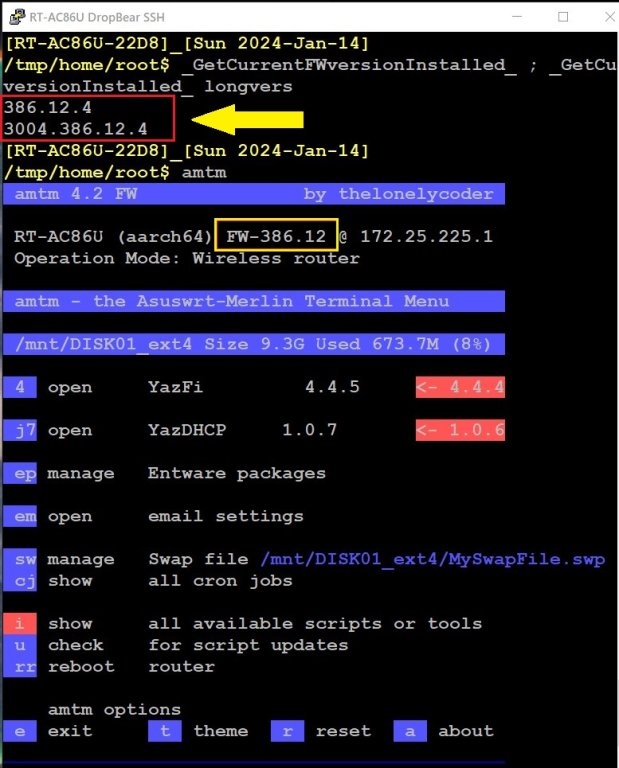

As in previous versions, when AMTM 4.2 CLI starts up, the currently installed F/W version on the router is displayed near the top of the header (after the router model & "machine hardware" type info). However, this F/W version is not the "complete" string that contains the revision/patch number (i.e. "extendno" from NVRAM).
For example, the latest F/W release for the RT-AC86U router is "386.12_4" but AMTM shows the version as "386.12" which is only partially correct (and yes, it's a very minor cosmetic issue).
Here's a screenshot that shows this "incomplete" F/W version string:
I propose that AMTM shows the full F/W version, either the long string "3004.386.12.4" or the short string "386.12_4" (either one would be fine, IMO).

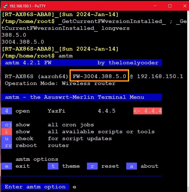

Here are screenshots that show the "complete" F/W version strings from an RT-AC86U & an RT-AX86S.
I'll submit a GitHub PR for AMTM to address the "incomplete" F/W version situation described above (a very simple fix).
Choose your adventure and keep it simple, the current, extended and useless info version:
echo " $model ($(uname -m)) FW-$(nvram get buildno) @ $(nvram get lan_ipaddr)"
echo " $model ($(uname -m)) FW-$(nvram get buildno).$(nvram get extendno) @ $(nvram get lan_ipaddr)"
echo " $model ($(uname -m)) FW-$(nvram get firmver | sed 's/\.//g').$(nvram get buildno).$(nvram get extendno) @ $(nvram get lan_ipaddr)"
Looks like this on three routers close by:
I am not sure it matters. The u function will tell you about an update and the full (useful) version number.

Yes, this is just a cosmetic issue, and it does not affect the functionality or usability of the s/w at all. So I understand when you said, "I am not sure it matters." Plus, you're not getting paid to do this work so it has low priority.
In a commercial product where we have paying customers (and where we're getting paid for our work), this type of issue would normally be classified with the lowest severity level, but still a somewhat high priority to fix because it's displaying "incorrect" information to the user. In addition, keeping a good "perception" of the product quality and the "reputation" of the company behind it would also be part of the impetus to correct as many of the "little details" as possible. Usually, this kind of issue would be assigned to a junior developer as part of "dotting the I's and crossing the T's" in preparation for issuing a s/w release before it goes through a testing & validation cycle.
So yeah, I get it. We are both operating under a different set of s/w standards, release requirements & circumstances so we have different expectations.
Just to be clear, I set myself high standards, I also have a job in the real world. It's just that the s/w team I work with for these free to use scripts is a one man show.
I have no customers and don't have to answer to a higher ups. I am the owner operator if you will.
My handle says it all, I prefer to work on my own as I am not a great collaborator and don't work well in a team. I am who I am. No offense.
However, I do have users like you that criticize and peruse the code or report shortcomings which I normally swiftly get after and have it done in a timely manner.
So, thanks for your input, it will make it into the next release.
