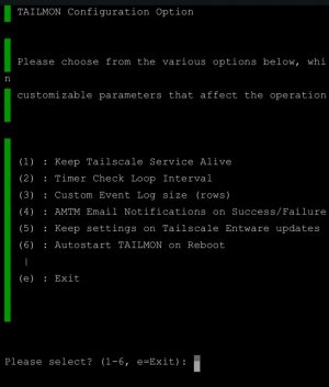

For Tailmon you can prevent Entware overwriting the install via option 5 in the Custom Config Options (not custom command line).
