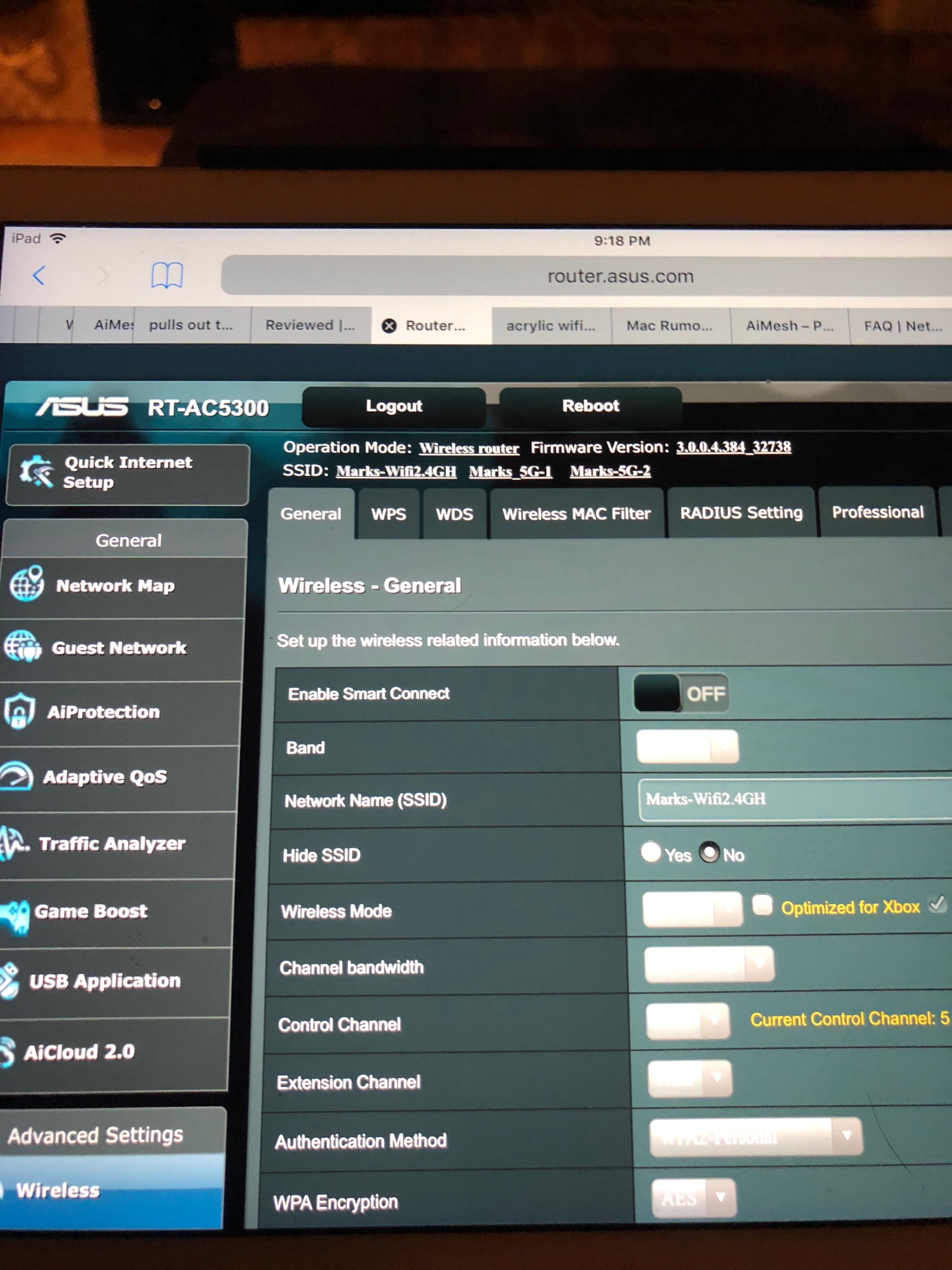

Never heard or seen that AC1900 got Smart Connect, can you show your wireless/general tab?
I would like to have Smart Connect too, but without the possibility to set channel and bandwith it is useless for me.
You are showing an RT-AC5300 with Smart Connect. It's the AC1900 that does not have Smart Connect, yes?
OE
to mix up 68U and 86U will happen often, but AC1900 and AC5300 ?!?
still searching for an RT-AC1900 or any 68U-type with Smart Connect, dont think they could ever exist so long as they all got same firmware.
