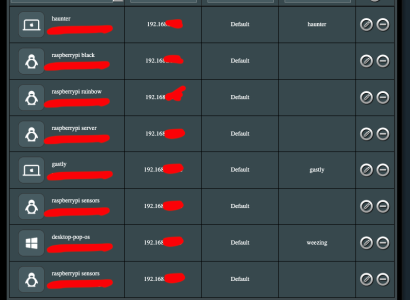

I've set up some host names in the "Manually Assigned IP around the DHCP list" in the LAN -> DHCP Server tab.
I use it to connect to various services on my network, mainly for testing servers locally.
Once I get it to start working, it works fine for a few days, but then I get connection errors on the host names (specifically failed to resolve errors, e.g.: "Failed to resolve 'hostname.lan' ([Errno 8] nodename nor servname provided, or not known'")).

In the meantime it could be useful if you post a picture of your "Manually Assigned IP around the DHCP list" together with a complete copy of the router's System Log (System Log - General Log).
Thanks, I've attached the picture and logs. Sometime between 1 PM and 4 PM I was attempting to access host names and resetting the router.

Thanks for the files. There's nothing obvious jumping out at me so we'll have to wait for it to happen again and try the tests posted above.
You should set System Log - General Log > Log only messages more urgent than = all so we see more useful information. Also, next time please don't obscure non-sensitive information like private IP addresses (192.168.x.x), MAC addresses or script names (e.g. /jffs/scripts/<URL>). It just makes things harder to diagnose.

I don't think I can show the mac addresses because they are hard coded into the device itself, so if I take those devices anywhere, they can be traced back to this post and all my other devices can immediately be identified as belonging to me as well.
