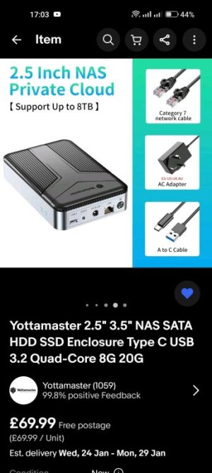

Nice, would that just connect to my router via ethernet + its own power supply? Would it take an NVMe drive and what sort of speeds would I roughly expect transferring from a desktop PC to that? I also seen this NAS enclosure on eBay which looks very compact would this also work and would there be much difference between them in terms of speed and how they operate? Thanks :)

Get something with a more recognizable brand name. It will have better software support. NAS boxes have own power supply and connect via Ethernet to your network. The cheaper Synology box in the example above has Gigabit Ethernet port and you can get about 100-120MB/sec transfer to another Ethernet connected client.

Will do thanks, 100-120 sounds a lot better than the 10 I'm currently getting and I'd be more than happy with that. Any idea if there's something similar in size that's more reputable than the one I mentioned? I'm a bit limited in space where the router is situated. Router is downstairs and there's very little space and I can only assume my partner would not be happy with another unit hanging around there lol. I also don't fancy having it in my office upstairs and running another ethernet cable up. Thanks 😄
Those speeds are 'up to'. And will almost certainly not hit 120MB/s in real life.
The speeds will depend on the drive used, the Ethernet chipset used, the file (and file size) actually being transferred, and the source/destination drive and client device too.
A single disk 'nas' isn't a NAS. Network-attached storage? Perhaps. But not a NAS.
I would recommend a QNAP or Synology NAS enclosure with as many drive bays as you can afford to buy today. Remember, you don't need to populate them all (right now).

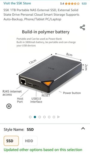

Thanks for that, I'm only transferring movies. Once they're watched, they're deleted from the NAS, so no need for any kind of redundancy.
I've done some more digging and I'm wondering what your take would be on this particular NAS and if you think it would work for what I would use it for? Appreciate the help!
