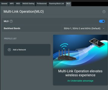

On the BQ16 (non pro) does the wireless mesh MLO backhaul only use the 5GHz-1 and 5GHz-2 or does it also use 6GHz too?
Bit confused as the official Asus site states 'Dedicated 5GHz backhaul'. Does that mean the 6GHz is not used for backhaul on the BQ16?
It will be weird as for the BT10 it states mesh backhaul uses both 5GHz and 6GHz.
The default on my BQ16 (as found on the MLO tab under Wireless Settings) shows both 5GHz and 6GHz for backhaul (with an option for 2/5/6GHz)
Are you able to share a screenshot of that screen? Thanks
