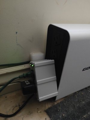

I had started with my BQ16 Pro on a simple surge strip, then added a CyberPower UPS, (simulated sine wave version,) and had serious performance issues. I ended up buying a pure sine wave UPS and adding a Tripp Lite ISOBLOK2-0 to one of the outlets just in case. (Pardon the dust)...
Plugging into the non-backed up side did seem to help, as well as distancing from the UPS...
I'll try plugging directly into a wall outlet to check next time I put these back in, I've put in my BE85s already, thanks.
