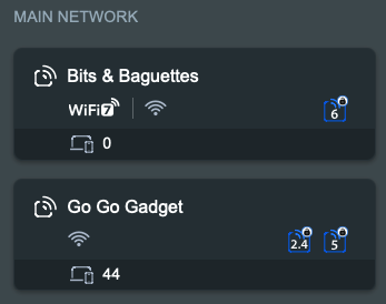

Based on your suggestions, I now realized that indeed I can create multiple Main Networks, as long as I don't have overlapping bands.
So I created my "main main" with only 6ghz and my "main iot" with 2.4ghz and 5ghz. However when I do that and I connect my MacStudio to the "main iot", I get weirdness on the bandwidth:

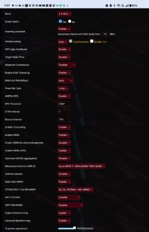

Ok, kept playing around with the 2.4Ghz Professional settings, - honestly went with my gut feeling and summary google search - I disabled anything that had Wifi7 in it and tried to put somewhat conservative settings (whatever that means) and landed on this:
To my surprise, it seems that now my MacStudio is "stable" (granted it's only been like 10minutes) on the 2.4Ghz band:
My iPhone has also been connected to the wifi network all that time as well... however the weird part is that it seems that I am not connected to Internet (loading a page or a speedtest will fail). But some devices work at least internally, was able to view a camera feed for instance...
I think I am going to try to re-enable the 5Ghz band now see what happens.

Try this as a base, exclude Wi-Fi 7 specific options, see if it helps somewhat:
Lower Tx power on 2.4GHz to Balance, disable all beamforming and OFDM, 802.11n only mode on 20MHz fixed channel, try to assign different clients to different nodes to spread the radio load a bit. Use flat network design for now with separate SSID per band until Asus figures out new AiMesh without Guest Network Pro. Lock 5GHz band to 80MHz on 36-48 or 149-161. Play with Roaming Assistant values, remove some nodes and try again. I don't know if you really need 4x routers. Home routers pump maximum power in an attempt to expand coverage area, but this may have negative effect. Can't really help much with exception of general recommendations. Every Wi-Fi environment is unique and there is no best settings.

Ok, whatever I did with the "professional" settings (mostly disabled anything that said Wifi7 in the name) tab for both 2.4Ghz and 5Ghz band seemed to have stabilized the situation.
I can now run my IoT network on 2.4Ghz and 5Ghz band - it's only been an hour or so, but my devices seem to be working fine (camera feeds are responsive, flair puck are connected, siri is responding fast, smart outlet/plugs all seem to be working) and I also have my main Wifi working fine on MacStudio, MacBook and iPhones (speed and stability is pretty good ~ 1200-1400 Mbps).
Here are a few screenshots in case people would like to see the settings:
Some settings:

@citizengris I have very few IoTs in comparison, but sharing my BE router settings for 2.4 GHz...
