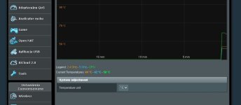

small upgrade :)) temps ok

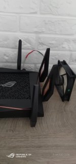

Heat kills electronics and Asus routers don't have very good cooling by default. For the AX11000, just put a 14cm fan on it and the CPU temp will drop ~20C. It's cheap and effective.
Looks good. And a filter pad. Very good, I like it. Heat does kill electronics indeed.
thanks bought a fan attachment on our local china china store here temps went down to 49c

For those of you who are placing a fan directly on top of the router, is it oriented to blow air down into the router or pull air up out of the router?
I'm blowing down and it seems to help a lot. I wouldn't want to get in a negative air pressure situation with the fan pulling up so it seems like pushing in fresh air from outside of the router is best to me.
