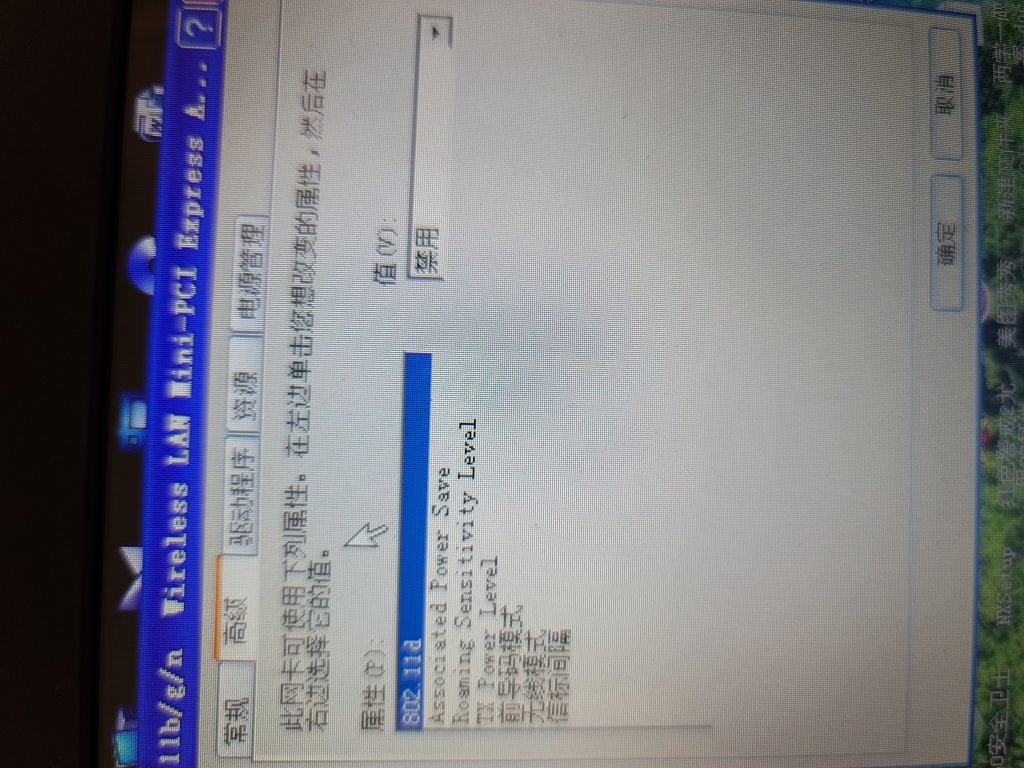

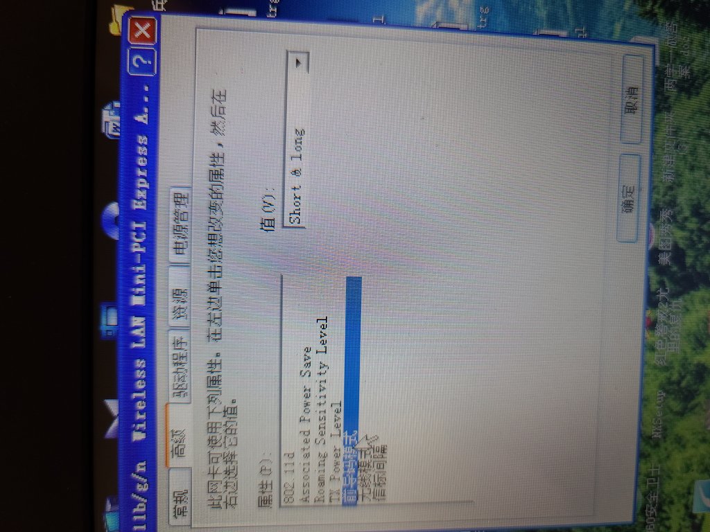

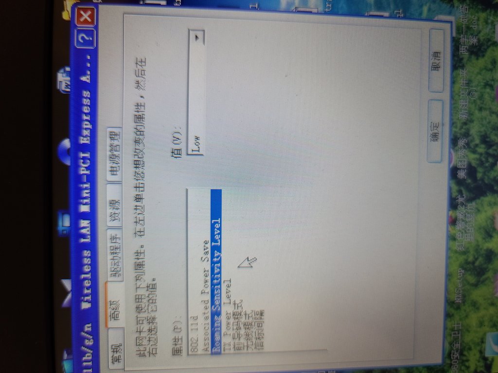

I have a old notebook thinkpad e40,operating system is windows xp sp3,its wireless network adapter is "11b/g/n wireless lan mini-pci express adapter II", I can not find wifi siginal in my computer from asus ax88u,but I can find and connect to my other routers'wifi and my phone's hotspot, how I can set the ax88u(2.4g) to solve the problem?

Is your RT-AX88U from the USA?

If not, I would flash a more current firmware on the router and then reset the RT-AX88U to factory defaults and change these settings only, at least to test with:
  • 802.11ax / Wi-Fi 6 mode to Disable.
  • Channel bandwidth 20MHz (or, 20/40MHz).
  • Control Channel '11'.
  • Universal Beamforming Disable.
  • Setting Region to the USA.
  • Leave the Wireless Mode to Auto.
And please, next time, post a larger image that we can read more easily. :)

I did all these you said, but it did not work, the firmware version is 3.0.0.4.386-41249

Ligiang2020,
I look at the images you posted, quite hard to read for my poor eye sight. I noticed you did not follow what L&LD suggested.
I am not familiar with your PCI-LAN adaptor; if I were you I would leave it at its default value and don't change anything unless necessary.
For your 2.4GHz settings on the Asus Router, you might want to consider to adjust the following:
Wireless -> General
  • Channel Bandwidth: 20MHz (you set it to 40MHz … problematic for crowded environment)
  • Control Channel: Use one of the channel from 1 - 11 (this range is acceptable to all devices / countries - Channel 12 may not be support in some devices/countries)
Wireless -> Professional
  • Explicit Beamforming: DISABLE (you set it to ENABLE)
  • Universal Beamforming: DISABLE (you set it to ENABLE)
  • Region: (your setting shows AUSTRALIA) you said you are in China? I suggest you leave it to the FirmWare default based on the country where the router was supposed to be sold.
Hope you get it working :)
