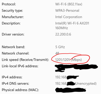

@bluepoint Sometime earlier today (about 10 hours ago) something happened. I didn't have a drop-out but my 5Ghz WiFi speed dropped in half. My PC WiFi connection shows about 10 hours of up-time. and the 160Mhz signal dropped to 80Mhz.
And, although my router is still showing control channel = 40, my PC is showing channel = 48. And, I still have 13 hours before the DHCP lease time is up.
Something definitely went wacky.
I will check again tomorrow morning. But this observation sure sounds similar to what others, even on other asus models, are experiencing.
☹️ so much for a stable config. Looks like Asus has more work to do.

I will add one more observation that may have prompted the router to change from 160 to 80 Mhz. My wife went out of the house and took her phone but left her 5Gz WiFi connection on. As she was leaving, her WiFi signal got weaker and weaker. It was at this time the router changed.
I am theorizing that this condition caused the router to change its channel bandwidth from 160 to 80. And when this happened, all other clients on 5Ghz WiFi experienced a reduction in speed.
Now, after more than 20 hours of my wife's return to the house, the router has NOT changed back to 160 channel bandwidth. I suspect it will stay there till the router is rebooted.

Others have reported RSSI conditions that affect 160Mhz Channel bandwidth stability. I have recently begun a test...
My Conditions:
  • "Channel bandwidth" = 160Mhz
  • "Control Channel" = 40 (manually set)
  • No AiMesh
  • FW 388_22525
  • Group Key Rotation Interval = 0
When Wireless > Professional > Roaming Assistant is [ENABLED], my router says:
"Disconnect clients with RSSI lower than [-70] dBn".
-70 dBn is the default value. When any of my 5Ghz clients fall below -70dBn (which can be observed on the System Log > Wireless Log GUI page), my "Channel bandwidth" automatically changes from 160Mhz to 80Mhz. This change to 80Mhz increases these client's RSSI to -68 (under the -70 default threshold).
When I decrease Roaming Assistant RSSI threshold to [-75] dBn, "Channel bandwidth" stays at 160Mhz so long as my 5Ghz clients stay above the -75 dBn threshold.
Working hypothesis: When any 5Ghz client falls below the RSSI threshold, the router automatically reduces the "Channel bandwidth" in an attempt to improve RSSI for those clients. Once "Channel bandwidth" is reduced, it never returns until the router is rebooted.
NOW, I've [DISABLE] Roaming Assistant. "Channel bandwidth" stays at 160Mhz. It has only been 2 days into this test. I will report back when more testing-time has passed.
