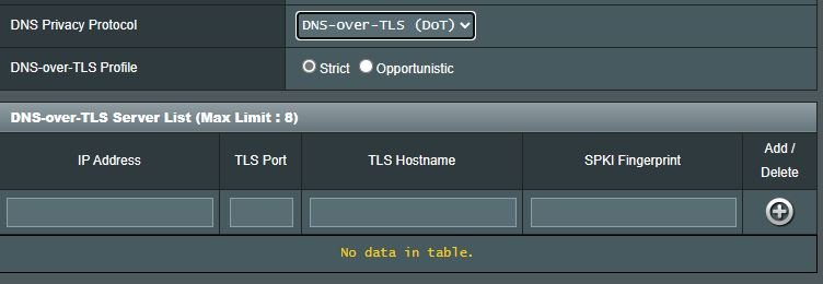

Just a buggy firmware update overall. No selection for DNS -over-TLS, guest networks do not function correctly over AI Mesh. I do not use cfg files. I have factory reset using both methods. Zero luck. I have reached out directly to ASUS on this one. Stay tuned.
You can enter DoT servers manually as a workaround.
DoT presets are downloaded from Asus' servers. Make sure you aren't blocking access to them, and check again if it has reappeared - I believe people reported that Asus' server that hosts these presets and AiMesh icons was down for a few hours recently.
In this case, there is no dropdown code in this firmware. They have the dot-servers.json file in /www, but they don't load it anywhere. Only the "regular" DNS list is loaded.
Odd, since the DoT dropdown code is present in the 388 branch (I've seen it in 388_24353).
The drop down is present in 388.6_2, and works as advertised. Flash back to stock. full reset, and no drop down.
Am I missing something on the AI Mesh and guest networks? It works on my RT-AX88U running either version of the latest firmware. On the PRO version, network says it is there, active on the node, but will not assign an IP. I turn off guest network to the node in AI Mesh, and it works fine on the primary router.
The option to enable/disable DNSSEC support does not appear on this firmware release either, despite it being present previously.
same issue in beta fw for GT-AX6000, no preset servers, no dnssec
