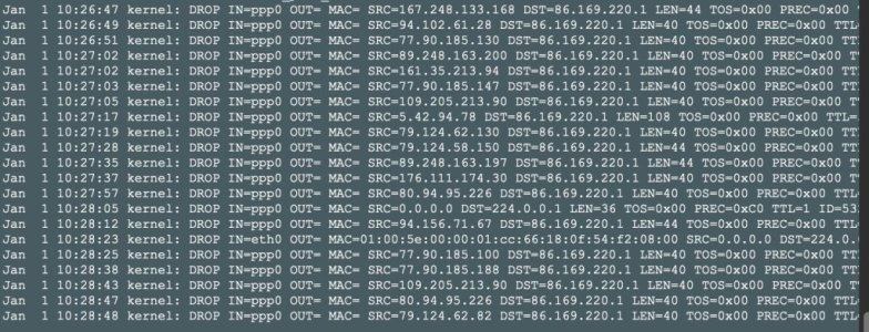

I have recently changed to BT Fibre and noticed dropped packets every few seconds. I have switched off the two nodes and removed all Ethernet cables leaving only my laptop connected to monitor the packet drop log. They are being dropped every few seconds. I am logging these onto my Synology NAS, which reports if over 100 logs per second occur. Yes they do. I have tested external monitoring but report no packet loss. I cannot understand why I get this situation on the router with only a single cable connection to the BT Fibre WAN, nothing else connected except my laptop wirelessly and its background processes. I tried it with a direct connection and it was the same.
Is this normal, or could it be the BT Fibre Network?

I am looking at the router log file. The 86.169.220.1 was my WAN IP address.

Those messages are to be expected if you have enabled logging of dropped packets in the router's firewall. Turn that off as all it will do is fill up your log making it harder to see genuine problems. They are normal port scanning/hacking attempts. Check that you have not enabled remote access from the internet.
Remote access not enabled. I will turn logging off. Thanks for the explanation, every little bit of knowledge helps.
