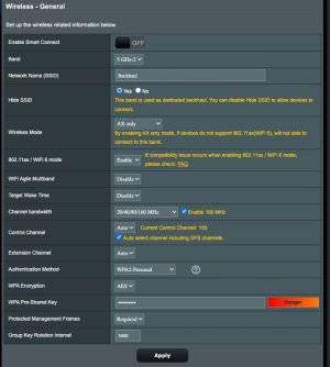

Just reporting an update :) over 12 Days without a reboot, and ram usage dropped down to 74-75% no random reboots and wifi has been solid. Here ae my backhaul settings if anyone is interested. Note: This is in the US
This is my setting, unfortunaly sometimes my connection goes on orange mode 2.4ghz low band.
I cannot switch to channel bandwidth 160 MHz only and Cotrol Channel 177.
I always have DFS channels, cannot leave them.
I'am in region europe so properly it is not allowed to switch off or have control channel 177 :-(

Sorry to hear that :( Back before they got approval for 169-177 in the US I dropped down to 80MHz and set a regular channel cause the weather Radars where I live are always being used.
Unfortunaely it is not possible, always the Radars are on.
Is it not possible somewhere in the software that you can say I am in region US so that you have different MHz open.
In the passed, my old router Linksys was it possible to say use region .... and you had different channels.
In this case I think it's better to toggle off DFS (might mean you can only use 80MHz bandwidth). It's still preferable to having the backhaul drop to 2.4GHz.
Hopefully Europe approves of UNII-4 sooner or later, as that is what unlocked the upper non DFS Bands for backhaul usage. I know this first came out with the XT12 Pro then was brought to the XT8 and XT9.
As far as changing regions, I did read somewhere that there is a or was possible, but I don't remember where it was was that could potentially get you in trouble if those bands are currently being used by an organization or the government in your area/region.
