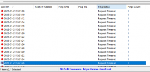

Disconnected every hour. Always. :mad:

3600 seconds, 1 hour. This maybe a problem. I have ac and ax devices, 2,4 and 5GHz. Disconnection is every hour.
I test each new firmware by setting this interval to something between 200 and 300 seconds and monitor pings. After 42095 only current beta (9.0.0.4.386_57317) passed the test.
For me beta 386_57317 disconnect regularly. 42095 works perfectly, with no interruptions. I set the interval to 0. I'll let you know.
