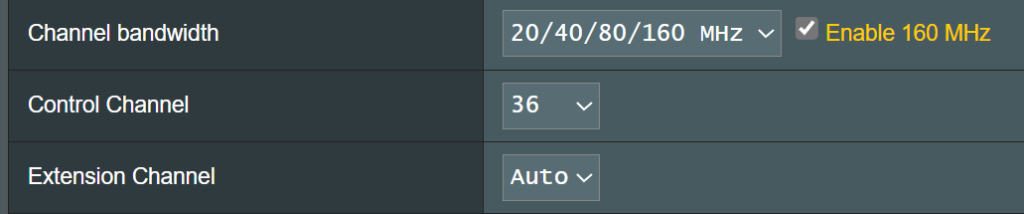

Is it though; shouldn't the dfs state remain as in-service monitoring unless it is tripped by radar ?
Channel 36/80 doesn't cover DFS so there's no need for ISM. Connect a client that's capable of 160MHz and I would expect the channel to change to 36/160 with ISM active. YMMV

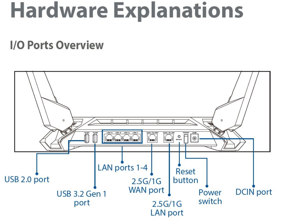

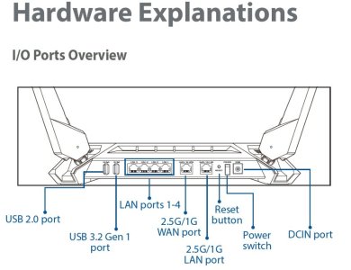

Your signature says you have a GT-AX6000. eth5 on the GT-AX6000 is the 2.5 gbps LAN port.
Thanks. I didn't realize that was the case. Are you saying that's a problem and the cause of the syslog messages?
This is the fixed channel config:
and this is the 160mhz capable client connected to it at only 80mhz and dfs idle:
Here it is when channel is set to auto, same client connects at 160mhz, dfs remains on ISM and time elapsed counter is running:
ISM been active now for 7+ mins:
After disconnecting the client, channel falls back to 64/80 but ISM remains active:
And then elevates to 64/160 when I connect the client again.
I would expect all this to behave the same if I choose a channel versus setting auto.

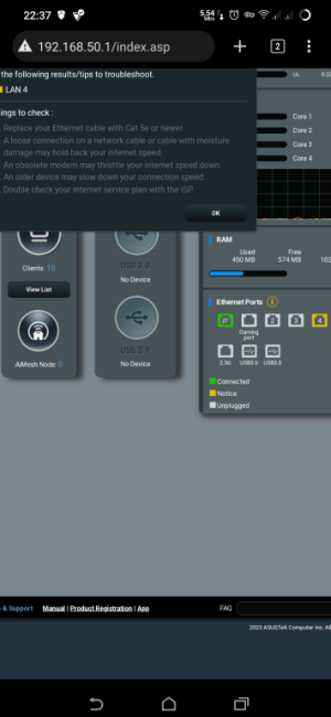

Yes, the messages are due the 2.5 gbps LAN port behavior. Do you have something connected to that port?
Yes, I had my Desktop connected to it. I have now removed the Desktop's ethernet cable from that port to one of the LAN ports.
I don't know why your client doesn't connect at 160MHz when using channel 36. Maybe there's some sort of limitation there that I'm not aware of (I never use channel 36 myself). As for your other screen shots, they are what I would expect. Channel 64 is a DFS channel so ISM should always be active regardless of the bandwidth.
The log messages indicate that the ethernet connection was unstable. If you are getting the same messages after switching to a different LAN port, then there may be something wrong with the plug on that cable (or on the 2.5 gbps LAN port).
Yup thanks for chiming in. @Damit1 had issues with 36/160 combo in the past but is using AX88's not AX86's like me, so not entirely a good comparison.
UPDATE: Turning 160 off for now but I'm concerned there may be a latent issue there on the 86u.
