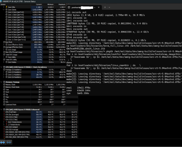

One note, it is ideal (not necessary) to have a fast machine as you could wait a while, if not. I used to build (for RT-AC68U) on an FX-8350 (quite legacy system) and that used to take like an hour if I recall correctly. Perhaps a little less / more. This (RT-AX86U Pro) firmware is bigger. I get this particular build done in sub ~20m on a Ryzen 9900x.
I suspect it will take a while. I plan on using Hyper-V (or at least try) on a Intel I7-1165G7. Just having a gander through the source code now to figure out where the kernel modules are set (as to include or not in the build).
WSL2 (quasi-vm) works A ok. However, I have built inside an explicit hyper-V native VM as well (on the legacy system), but I'm not particularly keen on its use. It will get the job done as well.
