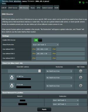

Is it possible to block ads with diversion for devices that on different VLAN for example 192.168.52.1, I tried the DNS Director but ads still showing.
I use iptables to redirect all device DNS queries to Pi-hole (192.168.1.4). Since Pi-hole runs on my NAS, I was concerned about potential app or NAS crashes or reboots causing name resolution failures across all devices. To address this, my internet monitoring script (running on the router) continuously checks DNS availability with Pi-hole. If Pi-hole is reachable, the script applies iptables rules to redirect all DNS traffic to it (see below). If Pi-hole becomes unavailable, the script removes the iptables redirection allowing devices to fall back to the router's default DNS behavior (e.g., 1.1.1.1). Once Pi-hole is back online, the redirection rules are re-applied.
I chose this approach over using DNS Director to maintain precise, predictable control over DNS failover & fallback. As for Pi-Hole instead of Diversion, the NAS' resources are larger than the router's and mostly underutilized so it made more sense to move DNS ad blocking to the NAS / Pi-Hole.
So in your case, to redirect all VLAN devices to Diversion, which is located at the router's IP, i would do:

Does Adguard Home uses the same port 53?
How did you configure DNS Director?
No problem using DNS Director to have two Guest Network Pro Profiles configured to use User Defined DNS 1 (a Pi-Hole). The Pi-Hole Query Log shows things are working with requests coming from both Guest Network Pro Profile's clients.
Edit to add: Note that there has been a slight change with DNS Director. Users may need to change the Global Redirect option to a User Defined DNS # rather than the previous setting of Router. From the DNS Director page:
A few special System options are available in the presets. "No Redirection" will bypass a global redirection, and "Router" will force clients to use the router itself as their resolver.
From the 3006 Change Log:
I'm aware of the change but just to be clear I used Diversion and AGH one at the time within the AMTM not from the external device. Diversion for example will set DNS Director to router by default, I tried multiple ways but doesn't work for me. I have not tried the iptable way like "copperhead" said yet.
