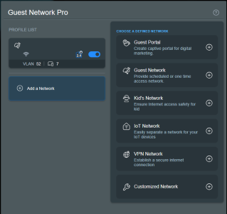

TLDR - Guest Network Pro and VLAN for physical ethernet ports. To me it seems like this was Asus' way to finally organize things a bit without using YazFi. And i'm still using custom scripts to adjust things further.

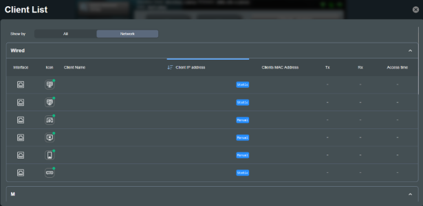

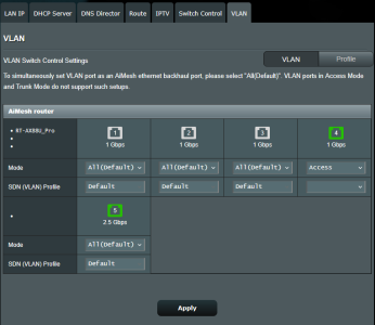

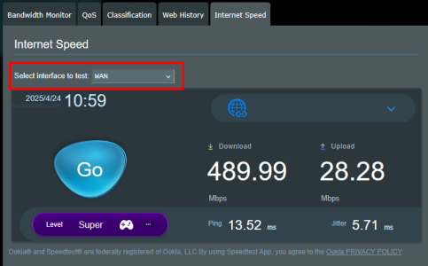

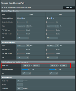

For me, the differences I spotted are attached:
* IPs and MACs are hidden in the images.
Guest Network Pro - Added
Client List - A visual makeover
Smart Connect Rule - Target Band showing multiple drop-downs
VLAN - Added
Internet Speed - Drop-down to select the Interface for testing (eg. WAN or VPN)
