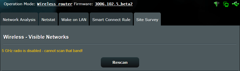

Installed 102.5 beta 2 the other day on my BE88u. Everything seems to be working ok with the exception of my 5ghz radio. I noticed walking by my router that the LED light was off. When logging into the webui, i see half of the green wifi symbol lit.when i hover over this green wifi lcon, it lists my 2.4ghz channel as 11 (which it is) and the 5Ghz channel as 0. Site survey works for 2.4ghz but says 5ghz radio is disabled but under wireless settings everything is set to auto and i can see that as far as the UI is concerned, its on. It has been working fine since about mid January. Only thing I have changed is disabling wifi7 as it gave me grief on one phone that uses my network.
I am running asus mesh and thankfully, my two mesh nodes (ax58u and ac68u) are still broadcasting their 5ghz radios.
Any ideas on where to go from here short of a factory reset and reconfigure? These latest builds allow you to edit wireless settings in the 'Network' sub menu (where Guest, IOT and MLO settings live). Should I remove the 5ghz radio from here and re-add it? It seems strange that asus now lets you configure wifi settings in two places.
Any thoughts?
Edit: Attached image showing 5ghz disabled. I have tried to enable and disable the radio and apply settings several times. No luck. I never tried beta 1 Came from 102.4.
Seems that others are having issues with radios since beta 1. I think ill sit tight as my mesh nodes are still broadcasting 5ghz until maybe a new firmware is available.
Edit2: is there a way to ssh in an force the radio on?
Channel 0 usually indicates either the radio is crashed, or the settings are corrupted. Try first to do a complete power cycle of the router do reset the hardware. If it still fails, next step is to do a factory default reset and manually reconfigure it.
After that if it still shows channel 0 then you probably need to RMA the router.
