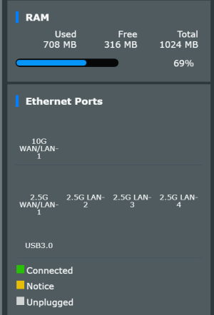

Anyone have this visual issue after updated to 3006.102.6 with BE92U?
