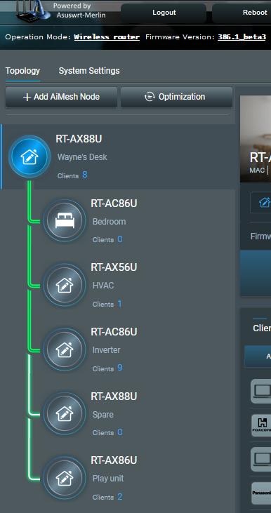

The marketing aim of AIMesh for ASUS was very obviously to sell more routers. And now some people have 6 routers in AiMesh config for a single house. Amazing - ASUS bean counters must be very happy
