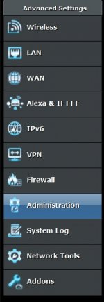

Smooth as silk to dirty flash to 386.2_2 from 386.2 on my AiMesh network, RT-AX88U, AX86U, AX56U, AC86U. Only quirk seen, after the update on the primary unit, no Addons Tab. Clicking on the Admin Tab, then Addon tab automatically appeared. All addon tabs within present and operational.
