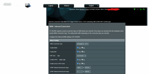

Hi all, I am a beginner for using merlin and appreciate the performance boost from it. But, I am facing a GUI problem that after upgrading the version to 386.4 in AX3000. As you can watch the attached screencap, the GUI looks very strange and missing menu on the left-hand side. It only appears in "WAN" and Firewall" pages and looks great in other pages. I would be very grateful if someone can save me. Thx~
Clear the cache of your browser
could it be that your hard coded fallback option is still active?
