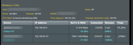

Just curious as to what you're looking at that is showing this changing between 160 to 80 and then back to 160 again?
System Log - Wireless Log - Wireless 5 GHz - Channel: 36/160

If you disconnect your 160MHz device and keep only that 80MHz device connected, your 5G WiFi should change to XX/80.
"acsd: eth7: NONACSD channel switching to channel spec: XXXXXX (XX/80)" will appear in the syslog.
