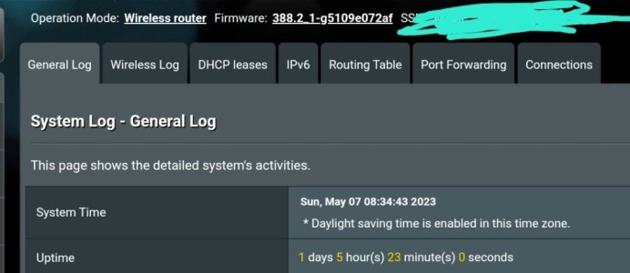

Almost 30h now, 36/160 is running.
Bunch of airplanes flew over me within just few meters, no issues.
System is way more stable here.
Cannot indicate or point which change (of the changelog) did this, but eventually- fixed some issues for me.
Even the AiMesh Wireless backhaul is stabler now for 30h, got to 2G/2G (never passed 1.9Gb/s previously).
Anyway, that way or another- good job @RMerlin , glad I donated 2nd time, you are way better than a stock in the term of good investment 😉😂
Thank you!
