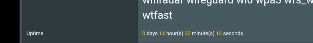

15H, so far- rock solid!

I think it is the best release for me in long-time, will monitor later on and report.
