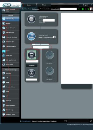

I installed ios 17 beta and now there are web gui errors on the iphone in the router's web interface. Will installing merlin 388-2-2 help fix this?
It a beta dude, maybe have fails the ios, not the merlin when stay the final release and the error continue, maybe in that time merlin say something.
That is ONLY iOS related (browser related!), not router FW...
Might check if any and disable dark theme for it..?
It is ONLY iOS 17 related (any browser, any theme). Some kind of incomprehensible system for processing pages and images. This is also noticeable on some other sites (mostly old ones). So I just asked - what if …
