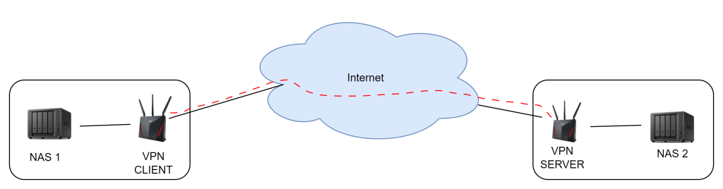

I am wondering if anyone else faces an issue with VPN traffic (upload / download) reported swapped, in the QoS section, first tab, the Bandwidth Monitor page. This is happening only on the router which runs the VPN server. The router which works as VPN client has its VPN traffic reported correctly. This is happening even if I turn off QoS. At the Traffic Analyzer section, traffic is reported correctly.

OK, let me explain. Here is a diagram showing my two Asus routers.
When NAS 1 sends data to NAS 2 though the VPN tunnel, at the VPN server router (right side) the traffic in the QoS pages is reported as upload, but in reality the traffic should have been reported as download. Strangely, the Traffic Analyzer shows the traffic correctly.
At the VPN client, the same TCP transfer is reported without issues, as upload. Both routers are running Merlin 388.2_2.

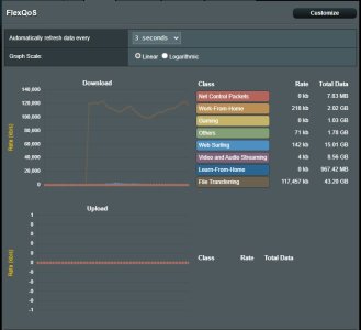

Posted this on the addon page but 388.2_2 still has issues with display of the upload stats. This is how it looks on my RT-AX88U (see attached). This issue was not present on 388.2. Note the regular QoS page is also messed up, so this is not a specific FlexQoS issue.

I had the same issue. My WAN type was PPPoE. When I changed it to AutomaticIP (by putting the VDSL modem to work as modem & router and take responsibility of the PPPoE call) the upload stats started to show up. Not happy with this workaround solution though.

Based on the evidence gathered, it seems the best path forward would be for @RMerlin to read the wan interface from /sys/module/tdts_udb/parameters/qos_wan when Adaptive QoS is active.
A similar approach was used several years ago:
