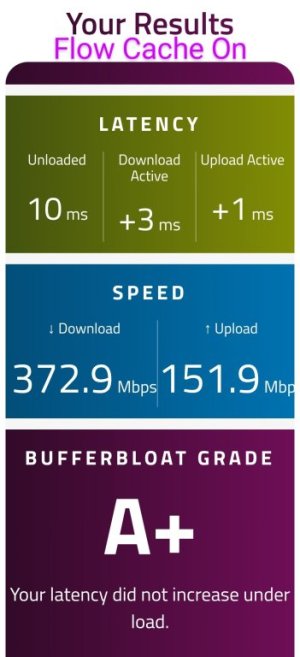

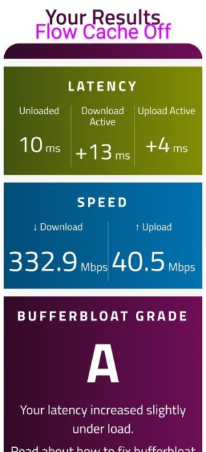

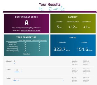

just punched in below commands
runner disable
fc disable
fc flush

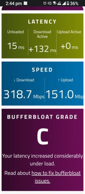

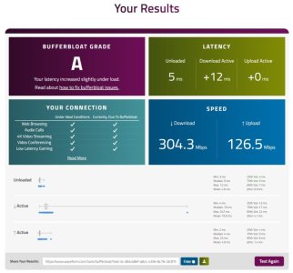

latency test is better on wired PC now but lost good test speed on Phone :(
its pretty much same as wired PC though

there is big difference between latency with FC On and Off on wirelessly connected Phone. with FC Enabled I get A+ but with FC disabled I get A. also different upload speed . Runner enable/disable doesn't really do anything for me at least for my setup for Ax6000.
I will test it on wired PC tomorrow again and report back. I know for sure that with FC disabled I get same ping response on both PC and Phone. However with FC Enabled PC is far behind Phone.
Also I have checked that I don't get a good latency by turning QoS/fw_codel off.
below screenshots are taken when no other device is using Bandwidth though.
If you're gaming, you definitely want to be wired if possible versus wireless.
In my environment, I do have 1 Xbox hooked up wireless upstairs with FlexQoS script installed in the router and it never lags while online gaming. My speeds are only 100/20mbps with Comcast.
Also....just remember that if you SSH into your router and disable those 2 options (H/W acceleration & FC), your speeds will be limited. So with your speeds I would definitely keep these options enabled for best results. Try to start setting the allocated bandwidth at 75% of your actual speeds for both upload & download speeds and test for a few hours.
Latency Below with FC enable and Disabled. it works opposite to how it works on Phone. atleast for me. Good latency on Phone FC Enabled. Good ltency on PC FC Disabled
There will be differences on each device due to specific hardware used in these devices and testing wireless vs wired. I wouldn't focus too much on this. Due some testing while gaming, web surfing or streaming and see if you notice any lag/latency in real world.
is there a work around to have FC Enabled permanently? it's automatically getting disabled randomly.
but isn't that something meant to be enable by default ? last thing I did was disabled it
Yes so if you disabled it you will need to enabled it again. Maybe a factory reset to the router will bring it back to default.
I did the factory reset and it's all back to normal as per FC enabled. just don't understand why PC starts to show latency when codel is on. my Hardware specs are pretty okay if not best.

and yes with QOS off I get okay kinda latency on PC but very high latency on Mobile. and I mostly play on mobile.
Yes bro. PC is connected to 2.5 port on ax6000. it's a fibre connection 500/50 but I do get about 550/190.
my provider is exetel it's Australian ISP.
On the mobile, have u tried connecting to both 2.4ghz and 5ghz? Do they get the same issues. Also within FlexQoS tried to toggle the QoS mode from Fq_codel to the default (Asus) option and test again.
have not tried 2.4 on this modem no. will do testing on default and report
I get really bad latency on 2.4 GHz. I have switched to traditional QOS for now as a trial. but latency on 2.4 is bad regardless of what I do. however 2.4 is reserved for all the other devices except gaming devices
