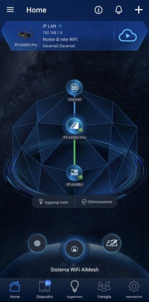

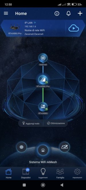

P.S.: The app will not be officially supported, but seems that's working fine
