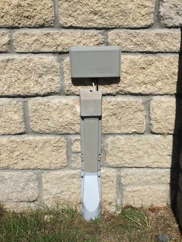

Going by your setup, it seems you have a FTTH/P connection. Based on your descriptions, the first box will be a Customer Splice Point (CSP) to which fibre is blown to: (mine is outdoors but yours may well be indoors)

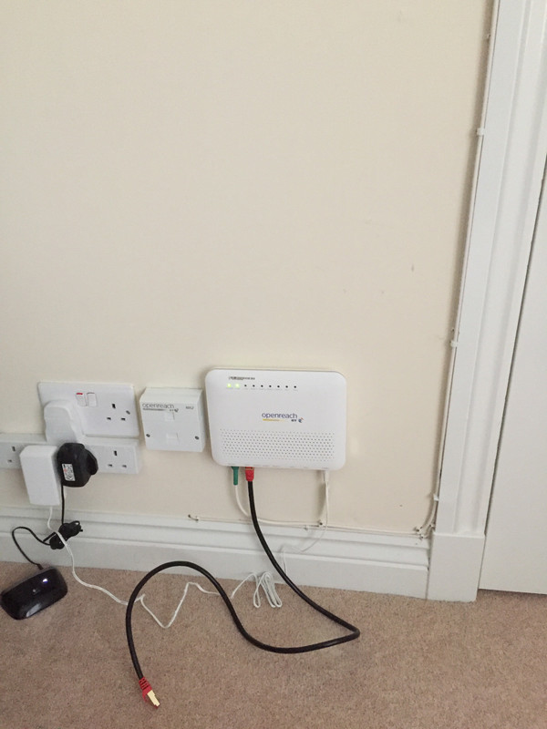

The second box (to which your existing router is connected to) will be the fibre Optical Network Terminal (ONT). Think of this as the fibre 'modem', though technically its not a modem:
Now, in theory you should be able to swap out the Thompson with the D Link (ensure it goes in same ONT port), however you may need to enter PPPoE login details in the new router if your existing router is using PPPoE authentication. You may need to contact your ISP for these credentials as I magine the PPPoE password field on the Thomson will be hidden. Of course if your ISP doesn't require PPPoE authentication then its not an issue but just something to bear in mind. In the UK, all Openreach based FTTH lines require PPPoE authentication.
