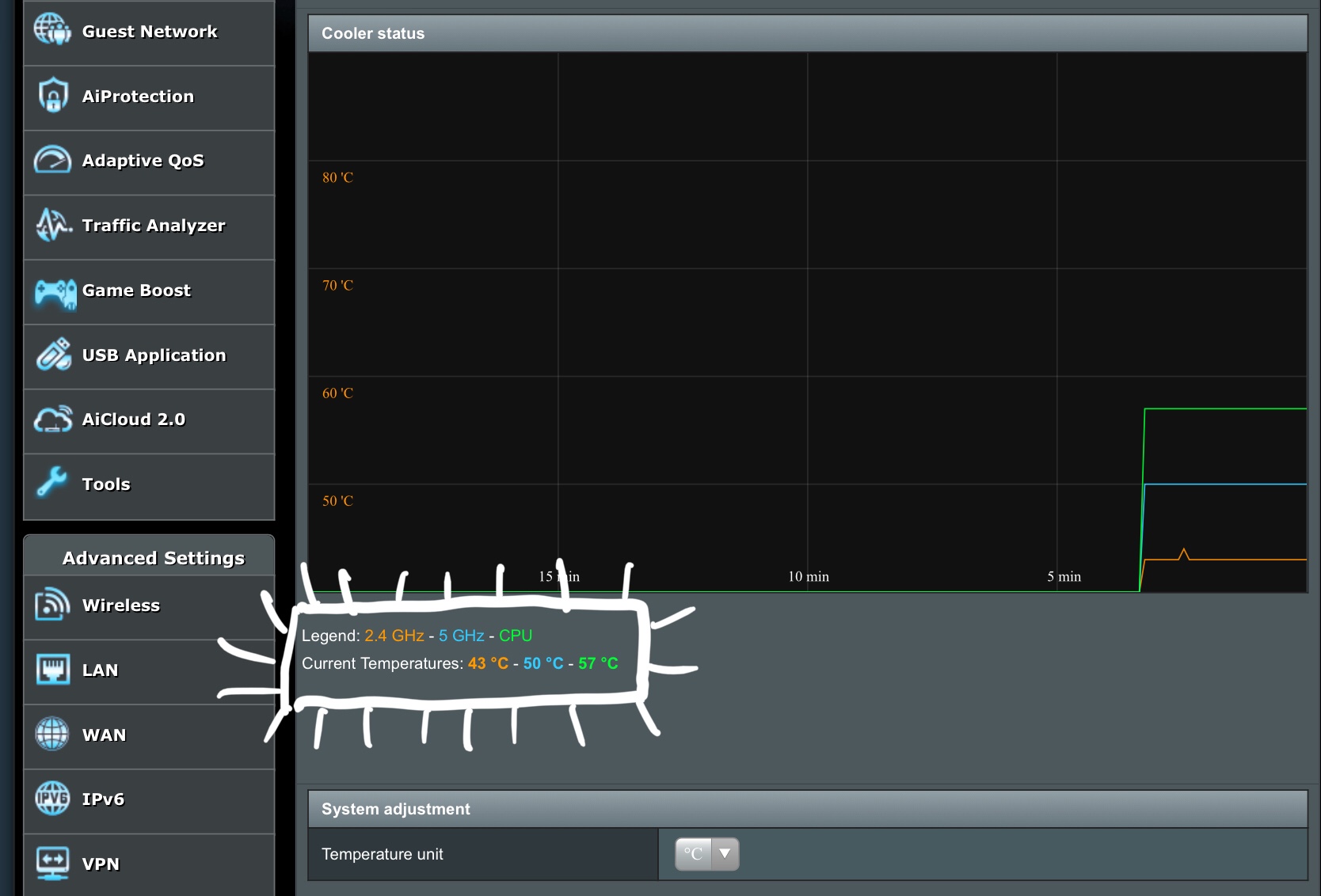

Just to add. Since adding a laptop cooler this is my temps. Before I was at 80-90 deg C across all three.
