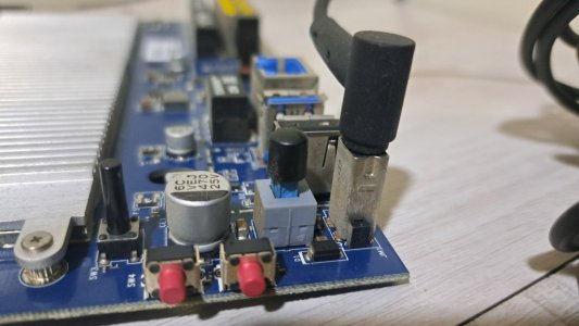

Rather than finding an identical replacement switch it might be easier to bridge the switch contacts on the underside of the PCB so that it's always on.
Probably with my little to none electronic knowledge Im assuming make it run directly when plugged in. If yes how to do it?

A common solution is to wedge the end of a toothpick into the gap. When you have found the right spot you can also drop a bit glue onto it for security. No need to open the case or fiddle with the circuit board.
Power button on one of my N66U broke recently. Fixed with the toothpick solution.

Sorry for late reply I tried toothpick trick and it doesn't work with me also in the power button I don't see any clip or spring but button still turns on and off
Thanks again i'll someone to do it for me i just need to them that i need to bypass the button and they should understand it right ?
Yes right, for someone with a bit of electronic soldering experience (not plumbing work) it must be an easy job.
